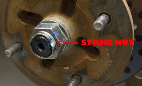

It is more of a "collar" that needs to be bent in. There will (should) be a groove in the outer cv joint where the threads are. You bend the outer most part of the nut into that groove......should be able to see it once you have the wheel off.....kind of hard to see in this pic
EDIT: Found a better pic.
Attached Thumbnails 1993 Accord rotor replacement.. Axle nuts??-spindle-nut.jpg   1993 Accord rotor replacement.. Axle nuts??-axel-nut.jpg

Originally Posted by 93Accord2.2
Do we need to be careful not to over tighten the hub nut? Is there a proper torque spec for it? (We're using air)
Thanks guys .... this forum it is great
The axle nuts are 184 ft lbs in the shop manual for your body style I replaced my rotors a couple weeks ago on a 96 accord so I remember. Ive used a breaker bar and basically stood on it I weigh about 175 so I figure Im close, but you should be able to reuse the old nut and it should line up with the old dent that was on it for holding it on.

I hope that )&$#)*%& is all back together right .. We torqued the 4 bolts on the back to 40lbs ... we didn't have a spec for the axle bolts but we torqued it down pretty good and then a little more with the breaker bar.. The indentation didn't line up but we punched it

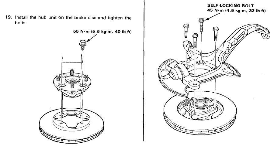

A few quick questions:
Is 40lbs alright for the 4 bolts that go in through the back?
Is the way we tightened the hub nut okay? I thought I read somewhere that it is not "for tightening but something else" or some kind of thing ... Is there anything I need to recheck or anything? I just want to be sure it is safe for her ... thanks again everyone

The axel nut is like 180 ft lbs, was in the pic I posted. for the others see this pic......40 vs 33 call if good.
Attached Thumbnails 1993 Accord rotor replacement.. Axle nuts??-4th-gen-hub-knuckle-torq.jpg
Thanks! The book we had described either piece for both specs, if that makes sense . . They both ended up at 40
