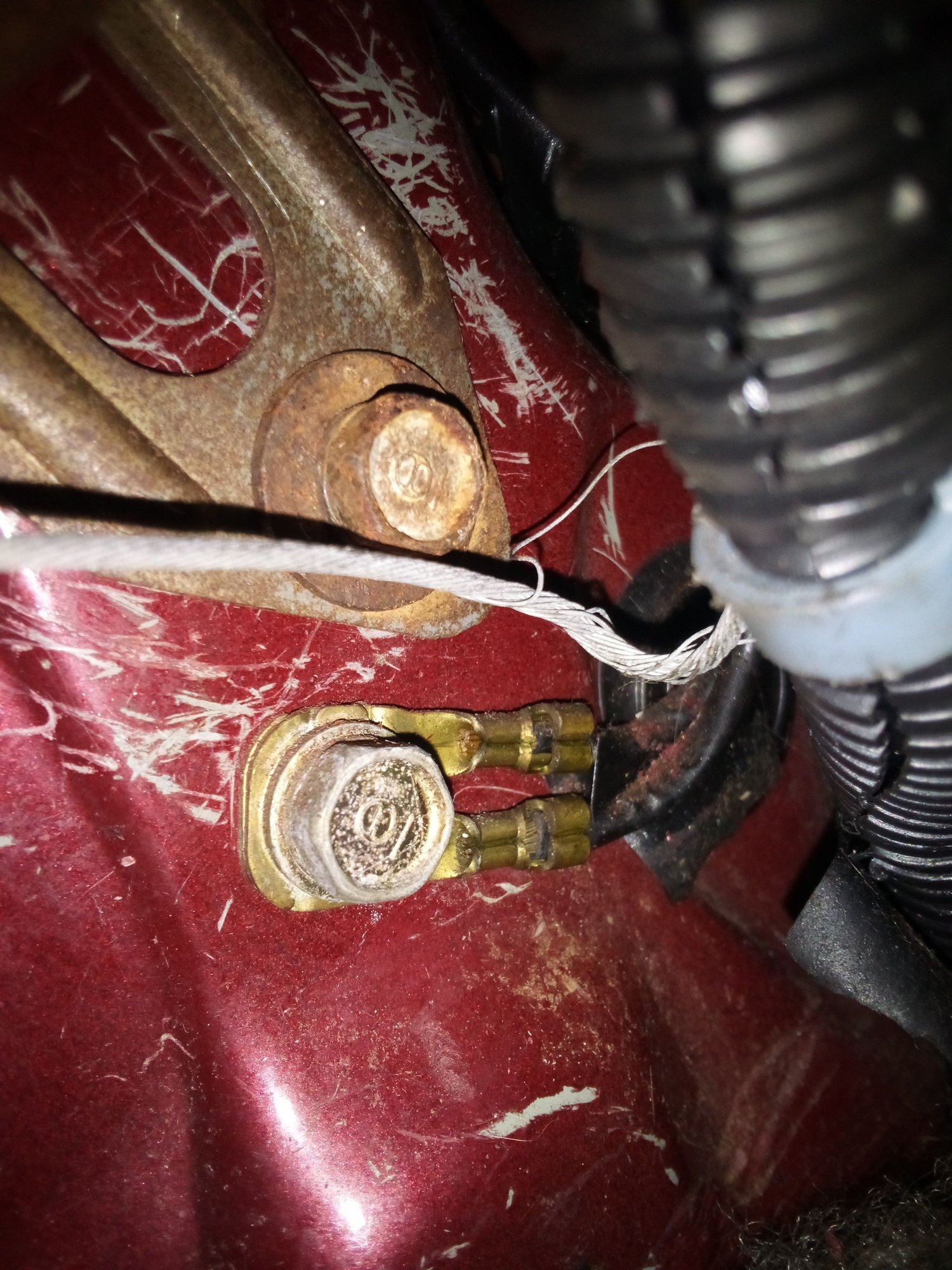

I may have loosed a wire or something. So I did a little bit research on this problem on a search engine. I found one thread were a guy had this problem and it went unsolved. Another repair website said something about checking certain grounds. I found the G401 wire behind the hood cable release latch. I took a picture, it looked good. But that wasn't the area anyways were I was swapping the TCU. The area is under the glove compartment and under the carpet. Now there is another ground wire. It's called G402. One graph indicates that is under the kick panel towards the right of the glove compartment. There is a panel one under the door. I removed that one. And there is another I removed that one. And I didn't find the G402 ground. And on another graph its towards the left of the glove compartment. I can't find that one either. If anyone has this honda accord near the same year. And can find it let me know. But there is a strange wire coming out of the glove compartment. I don't know what it does. I noticed there is electrical tape wrapped around it. Maybe that was the loose wire. I pressed on the electrical tape thinking that would secure the wires to be tight. I don't remember when and where and what was done with that wire. I'm tempted to unplug that wire and see what it does. Or taking the electrical tape off of it. I will upload the pictures to show what I'm talking about. Anyways, anyone know where G402 ground is? And what is the strange cable for? Or could it be something else that makes it blink?
Door lights flashing on and off from time to time.
G401 ground cable behind hood cable latch. It looks good.

The last picture is hard to tell exactly from the angle, but I think that is motor to open/close the air recirculation on the HVAC.
For the brake lamp/door, check that all the brake lights work when you press the brake pedal.
