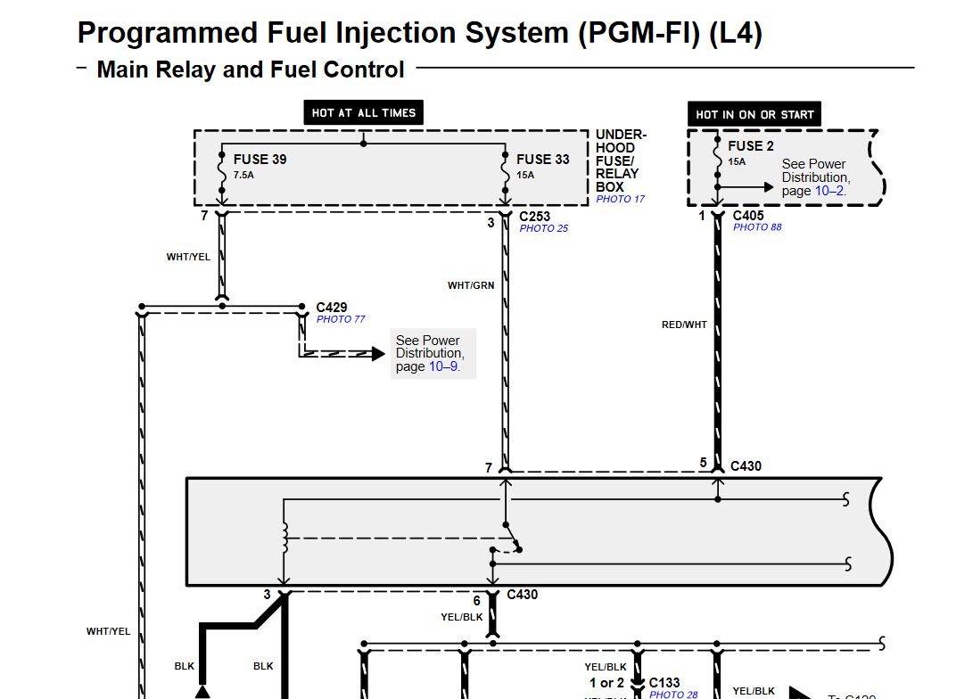

1994 Accord EX, blows PGM-FI fuse, no start, no spark
Old May 24, 2021 | 08:57 PM
Posts: 7,101
Yes, unplug the main relay and see if under-hood Fuse No. 33 still blows. If it still blows with the main relay unplugged, then there may be a short in the Wht//Grn wire that goes from the fuse box to the main relay.
