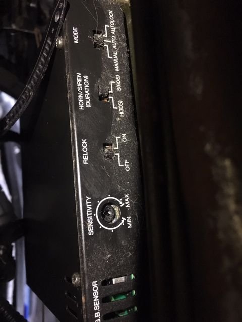

I have attached a few picts if that may help.
The security system is Honda installed , P/N: 08E51-SV4-300, REF No.: HS-5CH
The control panel box is mounted under the driver side seat.
