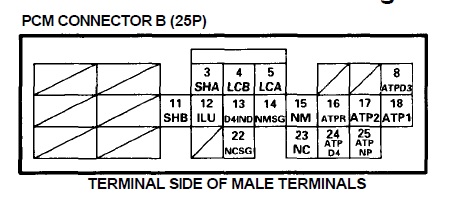

Posts: 16,337
Shift solenoid B will only have power when the green/black wire is supplied power from the PCM (engine/trans computer). Pin B4 on the PCM is the location of the green/black wire. The B-connector on the PCM has 25 possible wires that can go into and looks to have 16 wires. See attached picture of pinout. My 94 shop manual shows the wire color as green/white while the 96 manual says green/black. Just make sure the wire color is the same at the solenoid as at pin B4 on the PCM.
Unplug everything on the PCM. Supply 12V to that green/black wire at pin B4. See if you get a click on shift solenoid B and also measure the voltage on that wire with the solenoid unplugged.

I ran direct 12 volt to both solenoids of the lower cluster and both made the click so I retraced the wire back to the firewall and not brakes or issue..guess it must be an issue with the computer then...not sure where to go from here though
