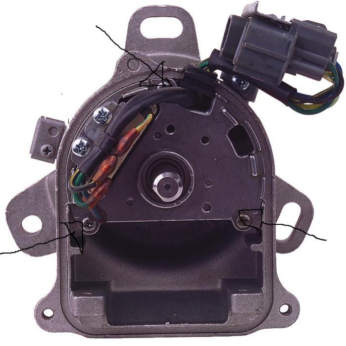

My distributor is set up differently than yours, so I am not sure which wires you are talking about. Is there anything in this picture that will make things clearer?

Yes that picture helps me so much.. here I edited it...the arrows are the screws I was talking about..
Do I have to remove those or just those two lower ones that are silver in the upper right corner of the picture?

Some of the wires you're talking about might be for the timing sensors down inside the distributor. Those don't have to come out, but I guess if they're obstructing your way to removing the ignitor you gotta do something???

it is easier to replace the igniter if distributor is out of the car,,
So if distr is on the car,, mark the position of the distr . unplug the connectors, remove the 3, 12 mm bolts, remove the distr,, i would advise to install a new o-ring..
once out......get a small screwdriver and pry all the wires off, I would write down the position so you put them back correctly, or just look at the pic above,, ,, remove the 2 screws , move wires out of the way , remove the igniter ..
i would install a Honda factory igniter, it is a bit more expensive they last a lot longer than non-factory

I got the ICM out...the part that I was having a tough time with was that the icm itself screws onto a bracket and then the bracket screws onto the distributor itself...I saw the screws that held the icm to the bracket and went wtf..(the ones that hold it on are on the bottom and hard to see).
Well I got it out and the one that they gave me @ Napa is the wrong part...I was going to post some pictures of why not but it was because the mounting flange where the screw goes was too thick. The screws that hold the icm to it's little bracket are very short and wouldn't go all the way though the icm into the bracket(not even close).
