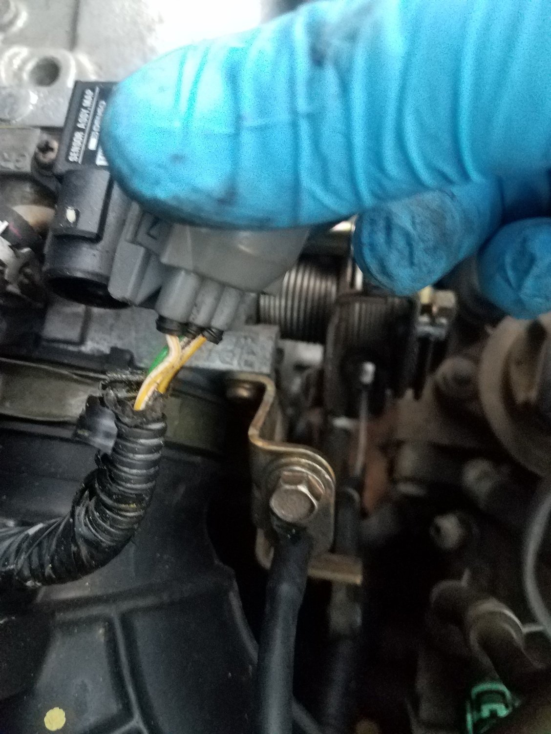

MAP sensor plug
Injector block plug, and main harness plug
As you can see these plugs are right. I'm not sure where to go from here. Plus how can that injector block get switched, there's not another plug right there w only 6 wires?

You have the map/tps connected correctly.
The connector on top of the bracket next to the resistor block with the 4 red/blk wires is for the resistor block. There is an identical connector (at least on the 95 accord) that is the exact same size. It may be the connector below with the blue wires. I can't tell from the picture, but make sure the connector on top actually feeds the resistor block and not something else. It's bee about 8 years since I owned my 95, so I can't remember where the other connector that was identical is located. This might only be able to happen on the 94/95. It is simple enough to check.
