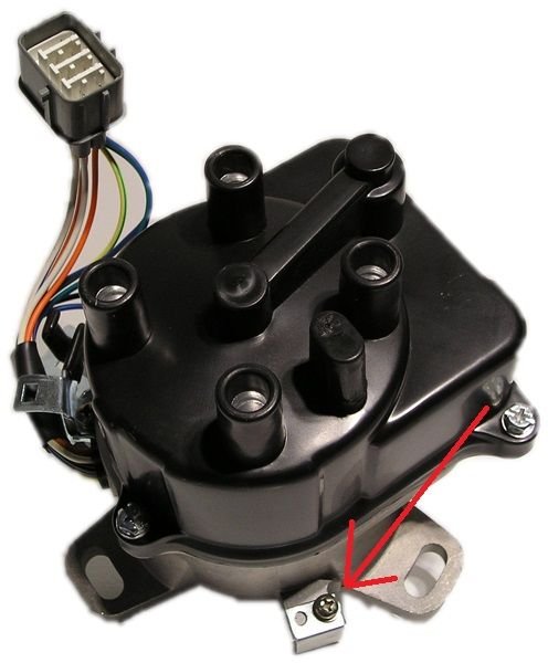

Ok, I saw the pointer on the timing cover but didn't see the other marks on the pulley wheel. I will check it with a timing light this weekend and see if I can see the mark locations. If the marks are out of range, does that mean the CKP sensor or ECU might be bad or is there some other way to manually adjust it? The original distributor had the oval slotted holes and the new one has two oval slotted holes and one round hole. Also noticed the new distributor has a screw that looks kind like where you would connect a ground. It wasn't on the old one so I assume it doesn't need to be hooked up. Do you know what that screw is for?

I didn't have a ground on my 95 accord at your arrow. It may be for a metal bracket that holds wiring. I typically look on ebay for used OEM parts pictures to see the OEM setup.
Your distributor picture has slotted holes, so you may be able to set the distributor where zero advance/retard is spot on. You would need a timing light. And I'm pretty sure you need to short the service connector under the glove box, to stop the PCM from adjusting timing. I'm not sure if this will make a difference, because I don't know the limits on advance/retard with the PCM.
