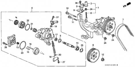

Old Apr 13, 2014 | 03:40 PM
For the alternator belt, you would first loosen the through bolt (so that the alternator can pivot), then loosen the adjusting bolt. See attached pic.
For the power steering belt, it looks like you would first loosen the mounting bolts so the pump can move a little), then loosen the adjusting nut. There may be a protective cap you have to pull off before you see the adjusting nut and bolt.

With the alternator, I have to remove the belt that goes to the a/c -- No big deal.
Now the power steering belt is the one with the dog leg I was referring too.
Gotta jack up engine and take that off?

Old Apr 14, 2014 | 09:22 AM
That looks like engine motor mount support.
Yes, you will need to jack up on oil pan w/ a wood block support on oil pan. Just take engine load slightly and remove part, allowing jack to assume load and hold engine position for re-installation.
