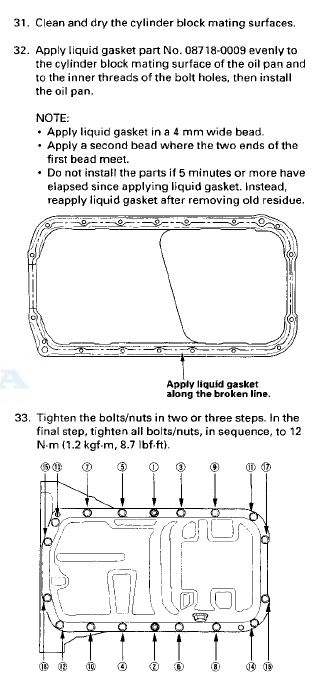

Never did a pan gasket what I owned that car, but I suppose the exhaust is the hard part. Also, there's stiffeners bolted to the block & the transmission that get in the way of some of the bolts. Then remove the sheet-metal cover on the bottom of the bellhousing to get the bolts along that end of the pan.
I think the pan doesn't actually have a "gasket" but rather the cast-aluminum pan is sealed with RTV. Shop manual says "Honda-Bond" but that translates into Permatex Ultra-Grey.

Then the other thing is getting the edge of the block & the edge of the pan very clean so there's no oil to interfere with the RTV sticking.

Here's what the manual says about installing the pan.
Attached Thumbnails 1998 Honda Accord -220,000 miles - oil leak-1998-02-4cyl-oilpan.png
