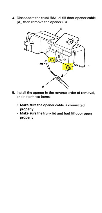

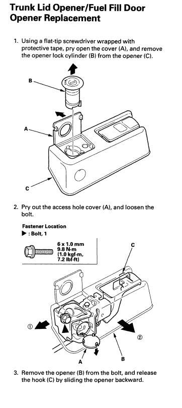

It sounds more like a problem with the cable at either the opener inside the cabin or at the trunk lid latch.
Although it can be a problem with the trunk lid latch, it sound less like that would be the problem. The latch can normally be open either with the key in the trunk lid (the key cylinder has a rod that attaches to the latch), the opener cable, or the remote (the trunk lid latch for EX trim levels have an actuator). -- Essentially, there are 3 methods to try to release the trunk lid latch on an EX.
  1. Check the cable is properly connected to the opener, see images.
  2. Check the connection and operation of the cable at the trunk lid latch.
