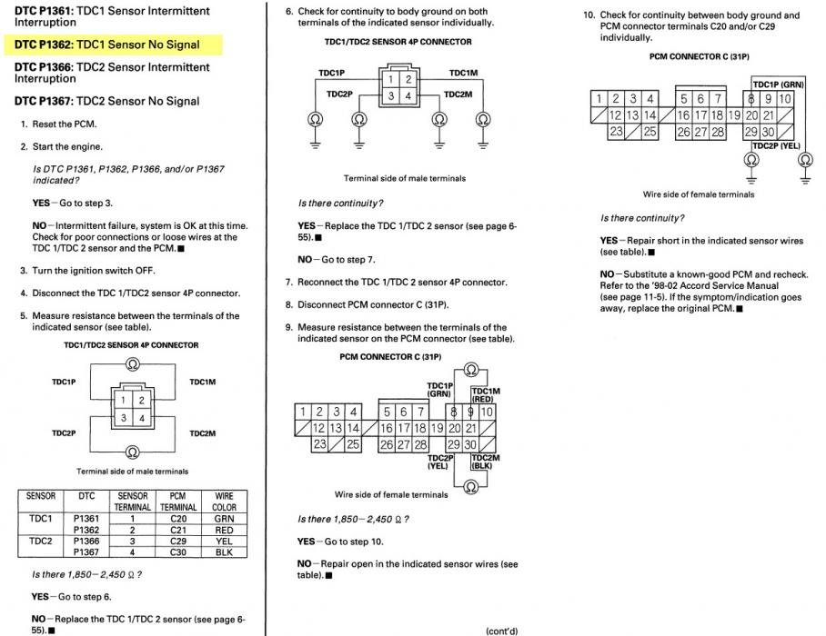

just tested it with scanner P1362
Old Jan 23, 2015 | 06:03 PM
P1362 is TDC1 sensor - no signal.
1. Inspect the connector, connector terminals, and wiring first.
2. If the connector and wiring look okay, unplug the connector, then measure the resistance between the TDC1 sensor's two terminals (No. 1 (Grn wire) and No. 2 (Red wire)).
Resistance should be 1,850 - 2,450 ohms.
3. Check for continuity between body ground and TDC1 sensor's terminals No. 1 (Grn wire) and No. 2 (Red wire), individually. -- There should be no continuity to body ground.
Attached Thumbnails 1999 Accord V6 cam sensor-tdc-sensor-connector.jpg   1999 Accord V6 cam sensor-tdc1-diagnostic.jpg   1999 Accord V6 cam sensor-tdc-sensor-replacement.jpg

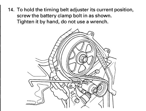

How do lock the down idle pulley to remove sensor...
Old Jan 24, 2015 | 06:44 PM
  #18
Wilke308's Avatar
Joined: Oct 2012
Posts: 39
How can I send you a Pic.... On what to do next.
Old Jan 24, 2015 | 06:47 PM
  #19
Here are steps #14 and 15, referred to in the TDC sensor replacement instructions.
To attach pictures, just use the Attach Files feature.
Attached Thumbnails 1999 Accord V6 cam sensor-timing-belt-adjuster.jpg   1999 Accord V6 cam sensor-idle-pulley-bolt.jpg
