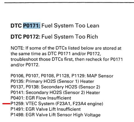

Old Sep 18, 2016 | 07:40 AM
Is this a four or six cyl car?
There are scan tools that will allow you to plug into the OBD port and read them.
Again, just me but I would want to solve the 1259
Attached Thumbnails 1999 Accord w/3 engine codes-p0171.jpg
Old Sep 19, 2016 | 10:11 AM
LS-300's Avatar
Joined: Apr 2011
Posts: 65
From: Miamisburg, Ohio
4 cylinder car. Cleared the codes and they haven't returned. I think there is a problem when the car runs in traffic on the highway. Doesn't the VTEC lean out the engine to get better gas mileage on the highway. The light has only come on twice but both times when the car has been on the highway. First time after exiting the highway the other in stop & go highway traffic.
Old Sep 19, 2016 | 11:07 AM
Vtec opens to improve engine breathing above 3000 rpm. Most highway cruising is under 3000 rpm.
When/if code/s return, scan them as soon as light turns on to see what code/s are presented.
