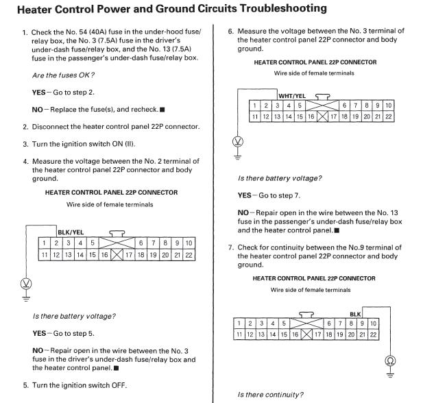

Test......you want to be sure that power is coming to the unit and that the unit has a good ground. You'll need a manual for the pins, I think I have a pic of the pins.

Got your PM. See if this comes thru.....
Attached Thumbnails 1999 Honda Accord EX Climate Control/Compressor Fan/AC Not Working!-6th-gen-hvac-non-auto-pins.jpg
