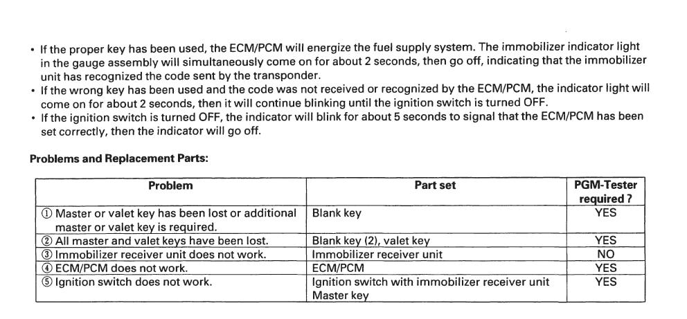

What is the "green key" light doing? Most of the time this system blocks fuel from the engine....not spark.
Is this a 4 or 6 cyl?
Attached Thumbnails 2000 Accord Crank no start....bad PCM?-6th-gen-immobilizer-light-description.jpg

Green light is not lit nor does it blink.....and it is a good bulb. Something is inhibiting the ignition system from geneating a spark. All components to create spark work. It lies somewhere in the control/ brains of the system. 4 cyl v-tec. Had to take it to the dealership for them to solve.
