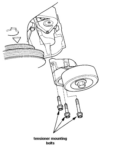

I couldn't get pulley off on the first attempt. Then read somewhere I had to remove entire tensioner, removed two bolts holding it on with no avail. Is there something I'm missing? This thing won't budge.

If you're referring to the auto-tensioner, three bolts need to be removed.
https://www.hondaaccordforum.com/for...er-removal-jpg
