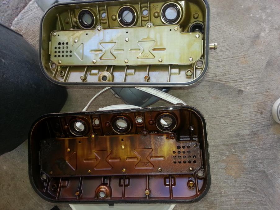

There were several intake valves loose, and a few exhaust tight. Way out of spec? Didn't gauge to see by how much out they were. Believe it or not one adjustment nut was off of #5 intake adjuster and laying beside spring.

That makes perfect since, thanks. My results were ok, maybe would better with this technique. But is retest necessary for better diagnosis? I have a feeling the tarnish on inside back cover had to with valves being slightly out of adjustment. Appreciate all the help so far.
