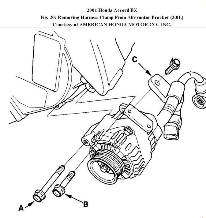

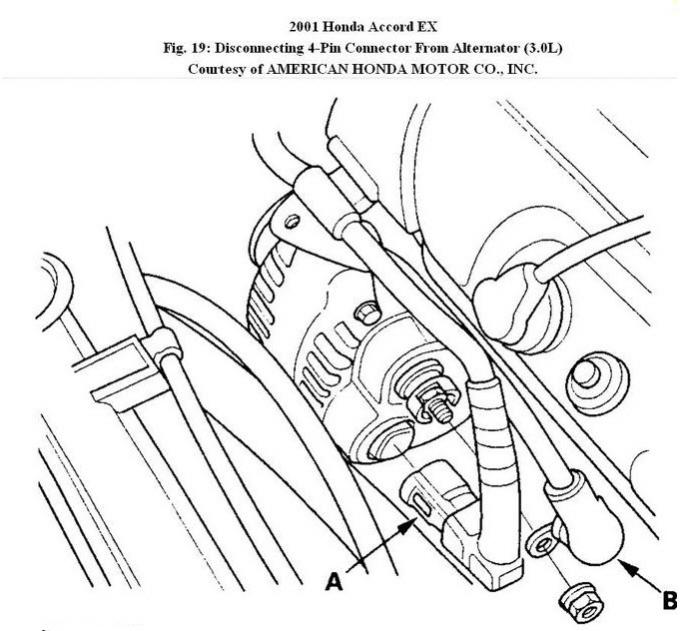

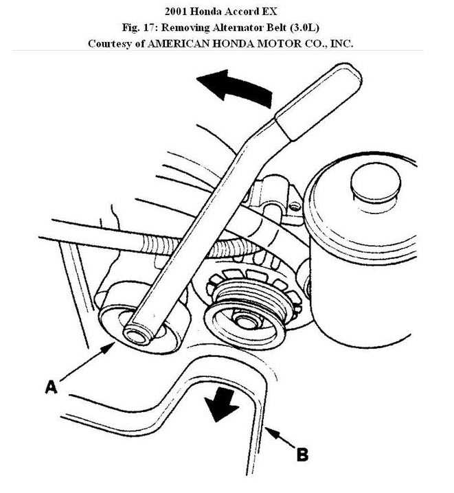

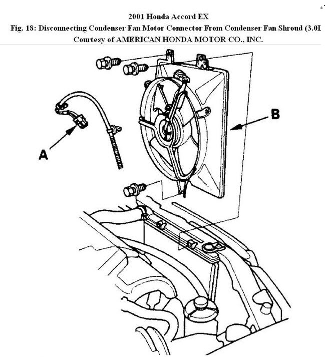

Old Jun 9, 2012 | 10:10 PM
Here's some more instructions.
Attached Thumbnails 2001 Accord Coupe Alternator Question-v6-alternator-1.jpg   2001 Accord Coupe Alternator Question-v6-alternator-2.jpg   2001 Accord Coupe Alternator Question-v6-alternator-3.jpg   2001 Accord Coupe Alternator Question-v6-alternator-4.jpg
