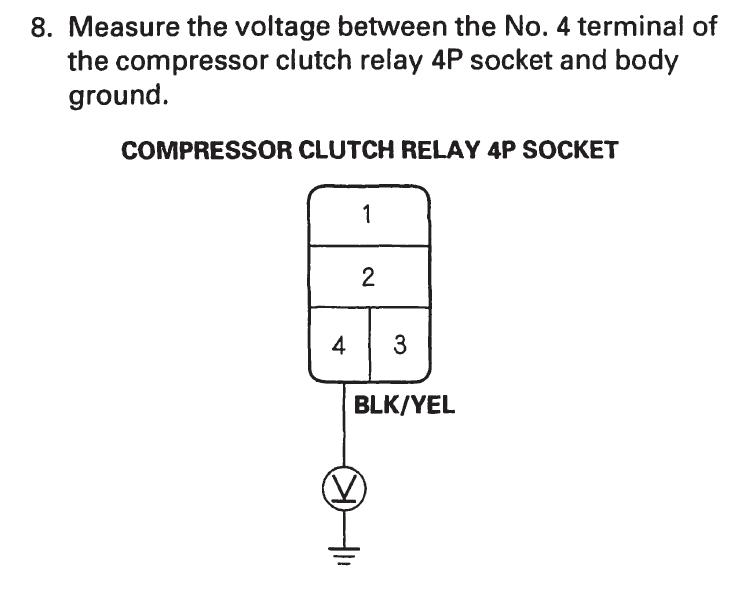

Just me but there is a common fuse involved here.
Can you verify voltage to the #4 socket of the AC Compressor relay with key on? ....from the female socket to body ground
EDIT: nevermind......I didn't follow the other branch from that fuse....it goes to the panel. Which seems to be working fine.
Attached Thumbnails 2001 Accord LX - AC clutch not working-6th-gen-comp-relay-socket-test.jpg
