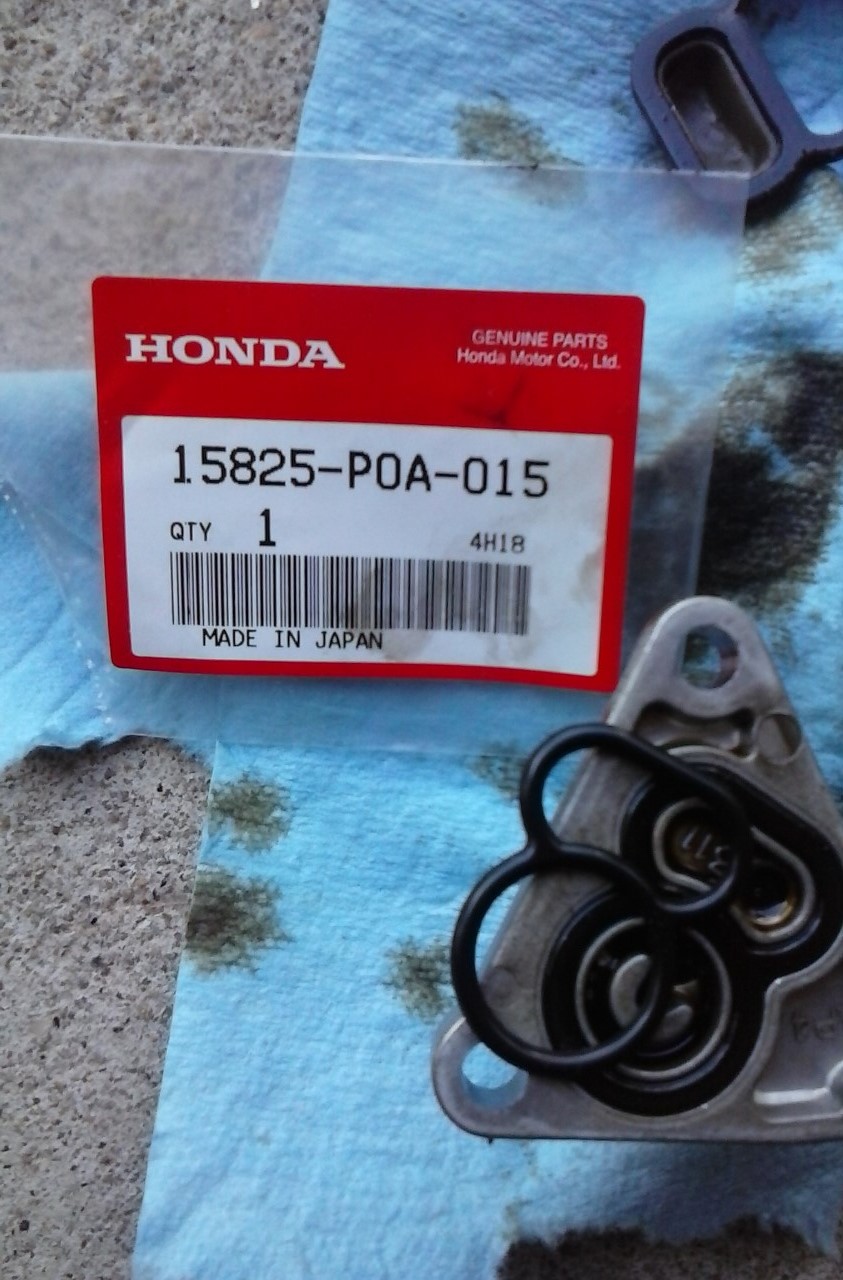

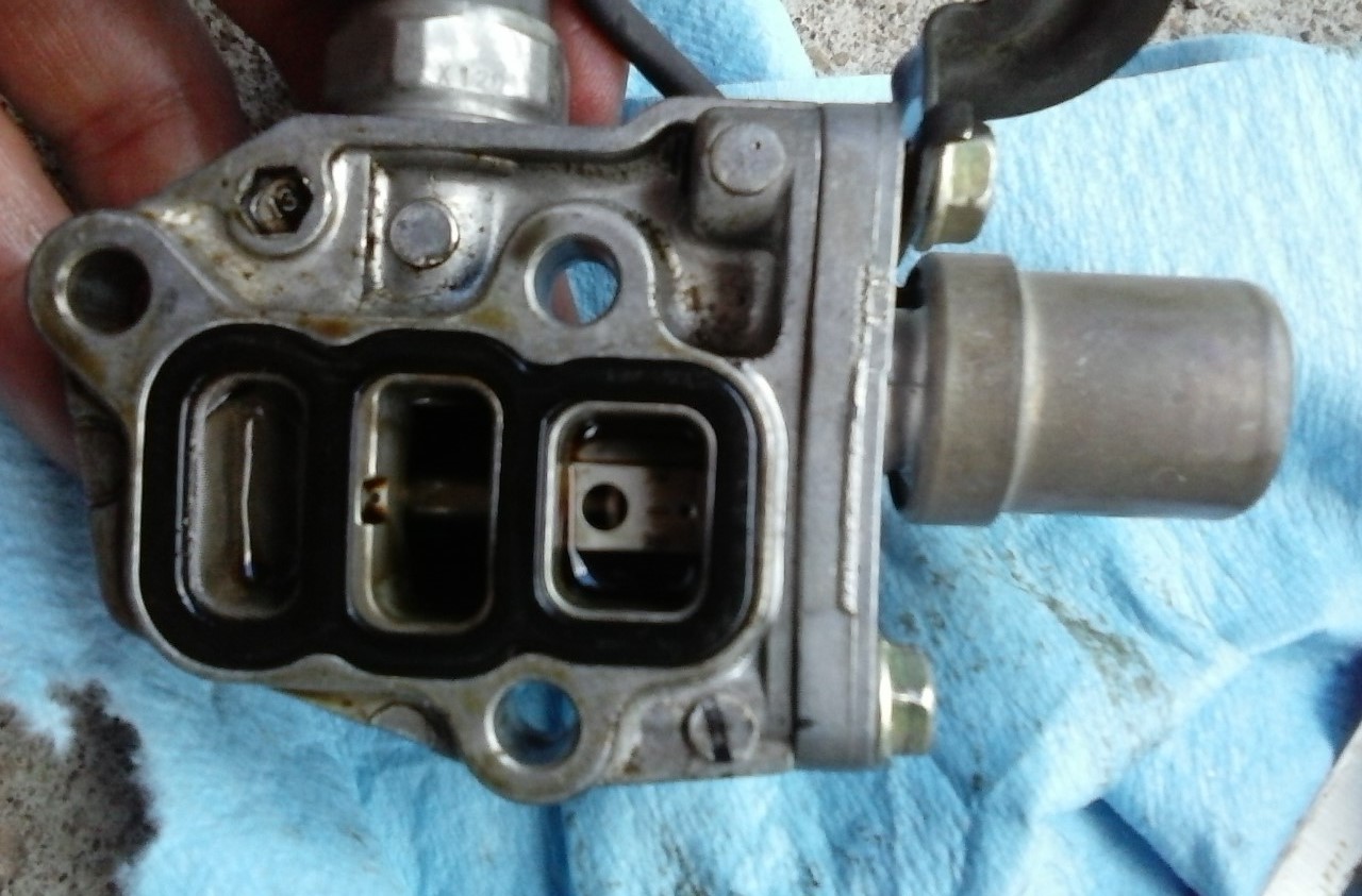

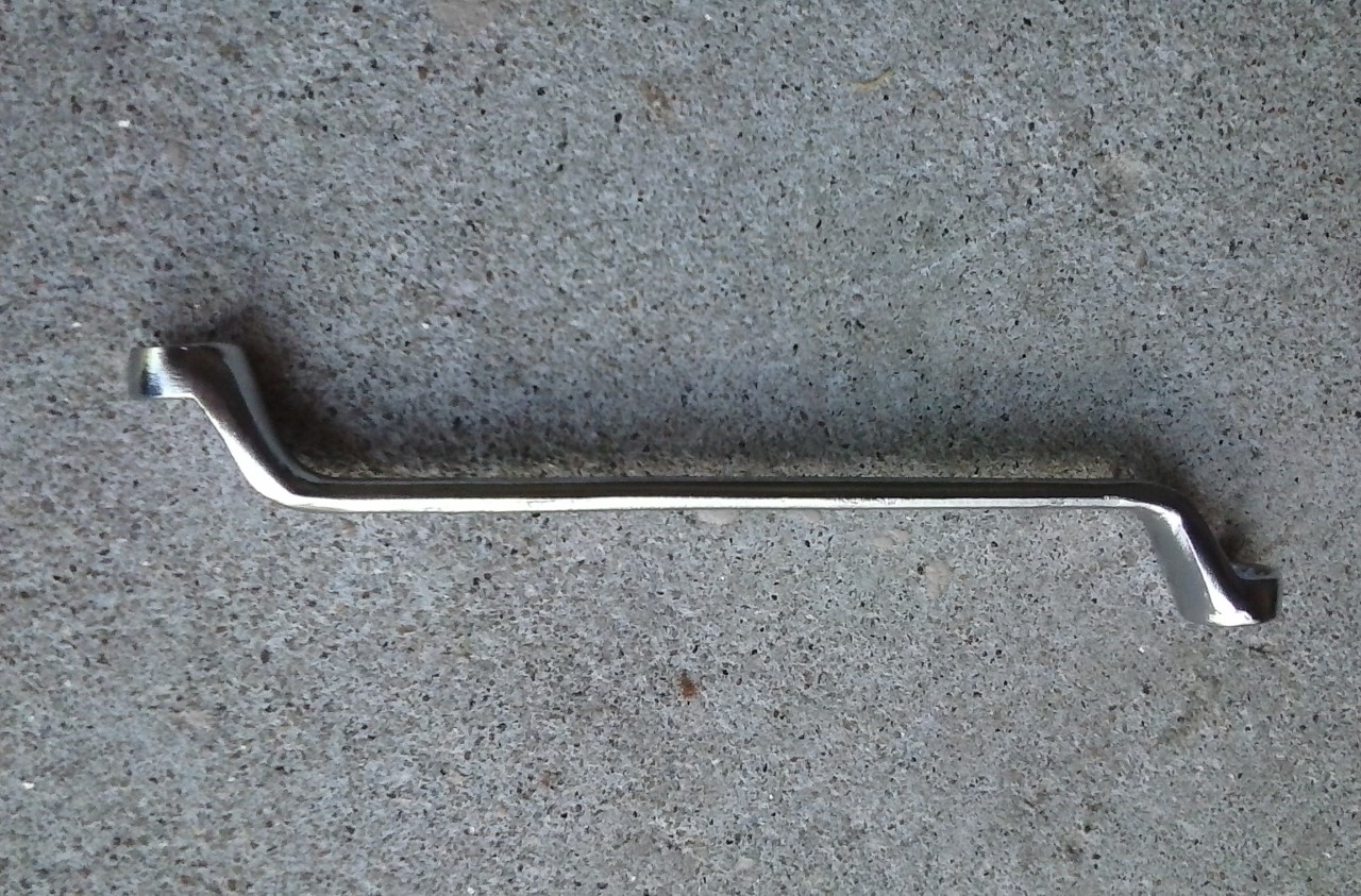

Update 04/23/16
Finally got around to replacing the upper and lower VTEC solenoid gaskets on my 2000 Accord 4cyl; it's real tight in there. Instead of removing the thermostat housing, I removed the EGR valve to gain access to the top left bolt. You definitely need the 10 mm box end wrench, and you have to keep your free hand on the wrench head to keep it snug against the bolts or the wrench will slip. Once you break the bolts, you can slowly unscrew the bolts by hand; a socket will assist in speeding up the process. Also, the upper gasket did fit perfectly even though it was not spec'ed for the model year. Photos attached. Hope it helps.. Also, the part number (15825-POA-015) shown next to the upper solenoid gasket in the photo is for the filter gasket, not the upper gasket; it's Part # 36172-POA-005.
