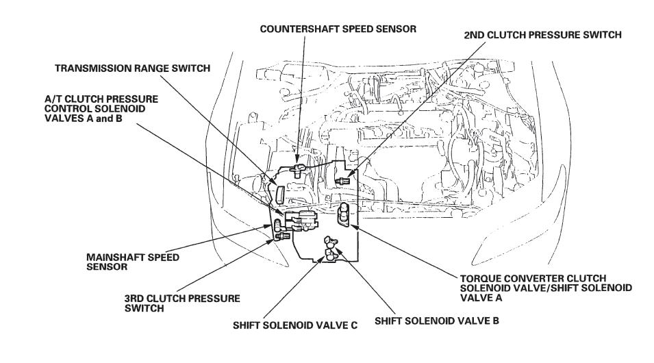

hmmm, so i assume either the A or B shift/clutch pressure solenoids controls the shift from 1st to 2nd and from 2nd to 1st? because for some reason when i was searching around i feel like i remember someone saying that the C solenoid controls 1st to 2nd shifts which is kinda what threw me off and partially why i think i am lost. thanks for the response!
and even after researching again i still cant figure out which solenoid is which. from this picture there is A, B, and C solenoids:
https://www.hondaaccordforum.com/for...oids-4-cyl-jpg

Clutch Pressure Control Solenoid A and B and Shift Solenoid B are clearly identified in the diagram. The parts diagram is unclear.
I would try to find used parts as parts replacement is unlikely to be successful. You could also just remove and test the solenoids for electrical function and sealing (light air pressure). They are simple reliable devices and rarely fail. You would have a different code if there were an electrical fault in any of these solenoids, so sealing is really only test. They could also be blocked w/ debris.
