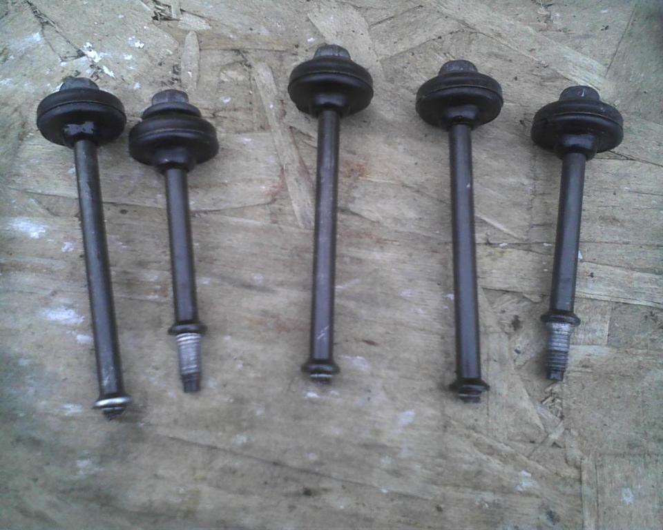

Thanks for all of this advice. I decided to order the tool off of amazon. While waiting for that to arrive, decided to do everything else. Wanted to do everything as per torque specs for the first time and gues what?....i sheared off the valve cover screws.....UGH. Any suggestions on this one?

i misread the torque specs. i thought 86 seemed a bit high.
