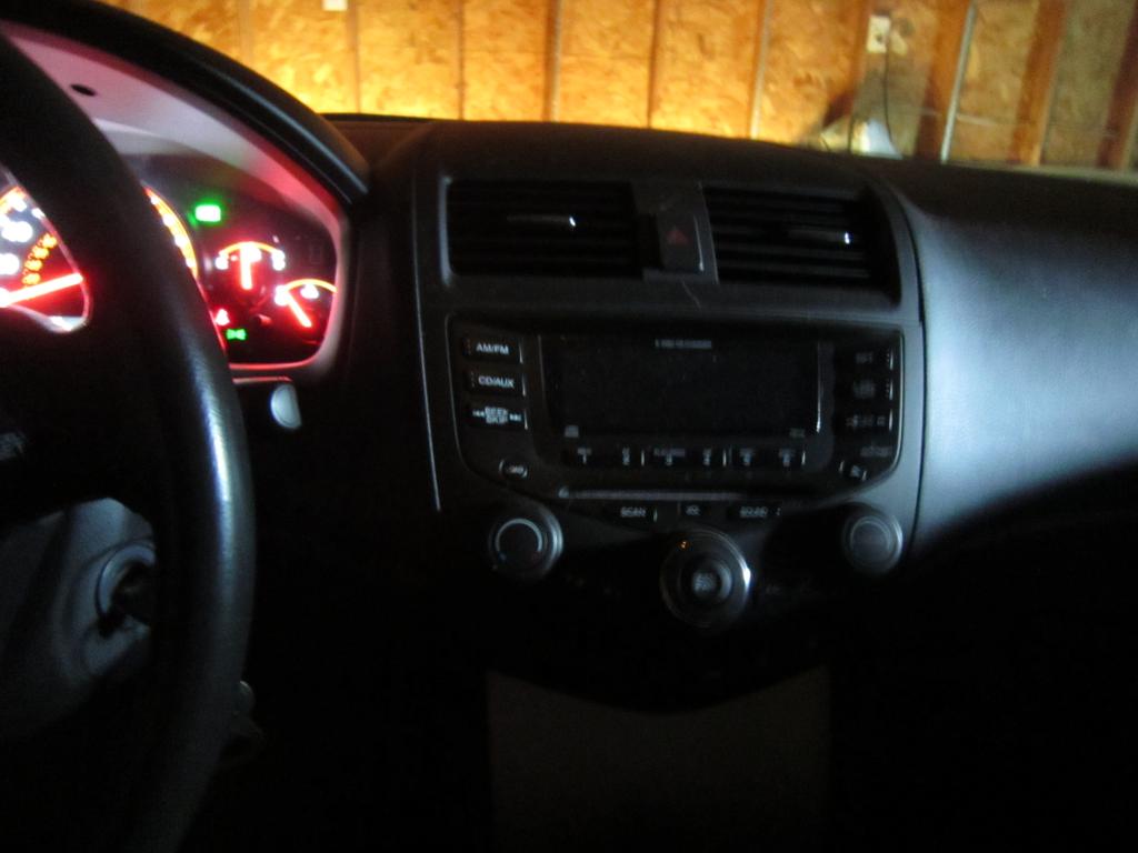

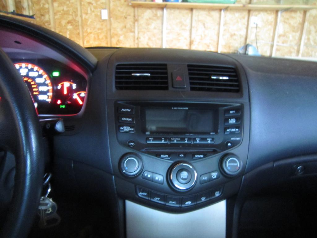

I have scoured this Forum to find an answer, but came up empty.
The backlighting for my audio system and climate control is gone.
I can barely see the display of the radio, climate control system during the day.
I have uploaded a photos. Any help greatly appreciated. I am knowledgeable with mechanical issues, but not electrical.
Attached Thumbnails 2003 Accord No Backlight For Audio, Climate System-003_zps43ea3b60.jpg   2003 Accord No Backlight For Audio, Climate System-007_zps6487451c.jpg

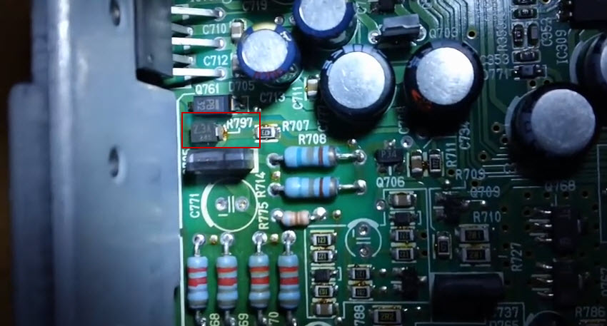

The part is a SMD (surface mount device) fuse aka varistor at circuit board location R797.
It is probably a Rohm Electronics ICP-S2.3 (rated for 2.3A, internal resistance 0.026 ohms), as a poster named joshhwwaaaaaa stated in the comments for this youtube video:
Mouser carries it for $0.74 each plus shipping.
ICP-S2.3TN ROHM Semiconductor | Mouser
However, you do need some soldering experience/skills for SMDs, as they usually require a little more experience to solder on.
Old Aug 16, 2014 | 11:03 PM
See image:
