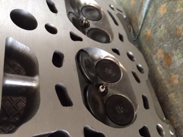

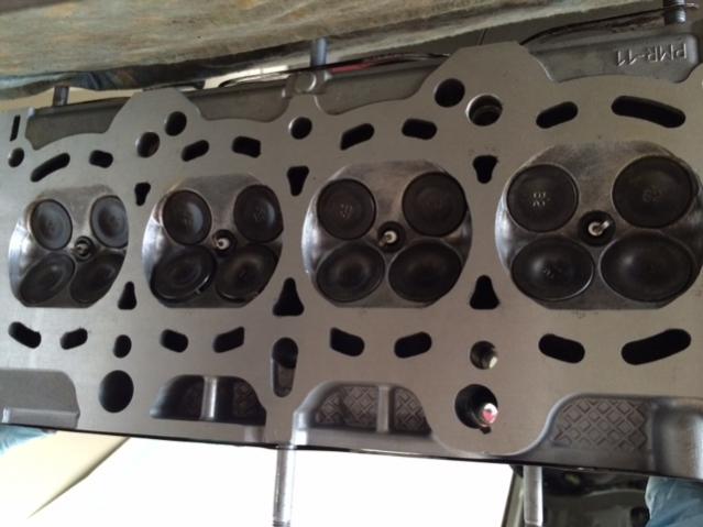

Can you please have a look at the attached picts?
#1 is at TDC and Cam 'Up' mark is at 0 degrees. But still #2 and #3 valves are partially open, is it normal or it means valves are not seating properly?
Please advise, else I'll again contact the seller.
Attached Thumbnails 2003 Honda Civic LX(A/T) Died While Driving-photo-1.jpg   2003 Honda Civic LX(A/T) Died While Driving-photo-2.jpg
Old Jun 22, 2014 | 01:51 PM
  #93
With the cam on - that is perfectly normal for the "other cyl's" to have some valves open.
Those other cyl's are in one of the other "four strokes" - or about to be.
Remember - intake, compression, power, exhaust. Somewhat simple way to think about it - TDC #1, means #1 is getting ready for the power stroke while the others are getting ready for one of the other three strokes.

#1 & #4 pistons will be at the top of their stroke.
#2 & #3 pistons will be at the bottom of their stroke.
#1 valves will all be closed.
#2 & #3 valves will be open a little bit because they are supposed to overlap a bit.
Not sure about #4 valves but should be almost closed (#4 is at top of exhaust stroke).
