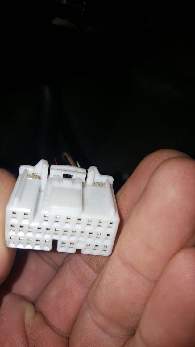

Refer to the photo in my previous post for Connector E. Connector E is at the end, with 31 terminal pins.
The order is A, B, C, D, and then E.

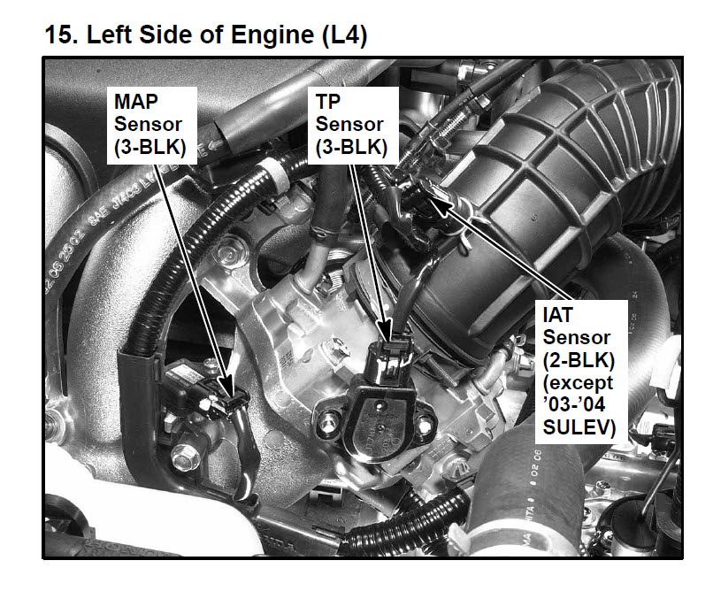

I forgot about this other quick check.
Unplug the connector to the Throttle Position Sensor (TP Sensor), you’ll get a Check Engine Light; but, see if you can shift out of Park.
If you can shift out of Park, power from the Brake Switch is probably passing through to the PCM, and the PCM is probably sending the ground signal to the Shift Lock Solenoid.

I did the test with the pcm plug mine is a little different than the picture but I test the port you said I have no power with brake pressed. I also tested the tps sensor the car reved a little but still couldn't get it out of park

On terminal 22 the wire was not white with black. I did use a jumper. I'm not good at this computer stuff I can't post a picture of if would you be willing to text me so I can send a picture to you

On connector E I will look for a white wire with a black strip but it will no be in the location you gave me do you want me to do this

I figured out the picture thing I will post one in a little bit of the plug

I should have included the following information regarding these Honda circuit diagrams. For female side terminal connector, the terminal numbering is on the wire side; for male terminal connector side, the terminal numbering is on the terminal cavity side.
