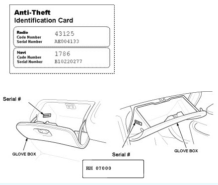

The dealership should easily have been able to get it for you with proof of ownership.
You can retrieve it via the American Honda website if Honda has your info.
https://radio-navicode.honda.com/
But, first, look in the glove box, there may a radio serial number sticker in there, see attached pic. Some dealers will put the code number along with the serial number sticker there. Also, look in your owner's manual package, if you have it, the card with the code may be in there.
If the website won't give you the info., you can call American Honda on weekdays or try the dealership again (with someone else). If the dealership has an Express Service, try them, those guys sometimes are more accommodating.

you'll need to get the code from Honda as explained above or on the sticky in the Audio section. the Code is specific to the head unit but linked to the car via the VIN.
course, it's an easy swap for an aftermarket.
