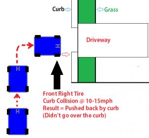

In January of this year, I was a genius late at night and turned too quickly into the driveway. I was making a right turn into the driveway, and instead of going up the ramp, my front right tire hit the curb, at about 10-15 mph. My car was pushed back by the curb, I did not go up and over the curb. (See diagram).

It okay to rotate the tires from front to back; but, that tire need replacement. If it was me, I would get new tires as necessary and then do the alignment; but, it is up to you especially if finances are a little tight right now. How is the thread on the other tires?
You should get the alignment checked and adjusted if necessary. You can go to the Honda dealership or any reputable shop. If going to the dealership, check their website for online coupon service specials first.

could have something to do with a faulty "pepsisters" alignment job. get the two best tires on the front, buy new ones if you have to, and then have it checked/aligned...call pepsisters first and see what their guarantee is on the alignment.
