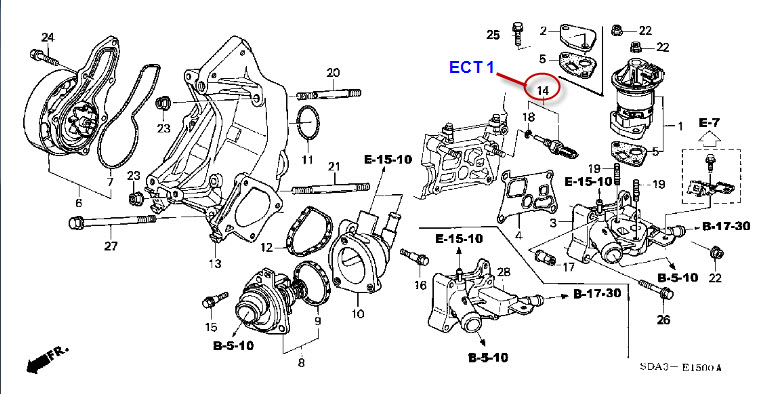

You may want to also check the cleanliness and tightness of the connector for ECT sensor 1, which appears to be located near the EGR valve.

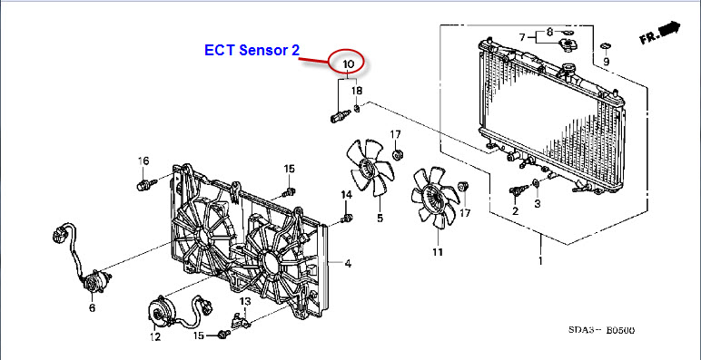

ECT sensor 2 for the 4 cylinder is located at the bottom of the radiator.
Attached Thumbnails 2006 Honda Accord PO128 Error code-ect-sensor-1.jpg   2006 Honda Accord PO128 Error code-ect-sensor-2.jpg
