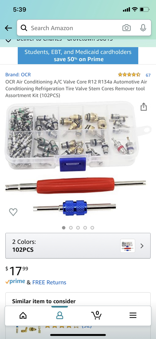

Replacing the schrader valves is very easy. Then you can pull a vacuum on the system, close the red and blue valve on your manifold, shut off the vacuum, then see if the system holds the approx -29 psi vacuum the pump puts on the system.

Good info, thanks. I'll definitely get a vac pump. Where is a good place to get the schrader valves and removal tool? There's a ton of them online, just want to make sure I get the right ones that are good quality. I have a recharge can with a hose and gauge. Can I use that or is it better to use a can I can attach to the refill hose of the manifold gauge? Thanks again, really appreciate your help!

Below is a good kit to get. You do what feels comfortable for you. I would personally use the manifold but then again I've been using it for years so I'm comfortable with it. I just don't like the quick fill cans because I like to see what both sides are doing while I fill.

I got a schrader valve tool at the autoparts store and it was pretty inexpensive. I don't have any information on good vs bad brands for the valves.
