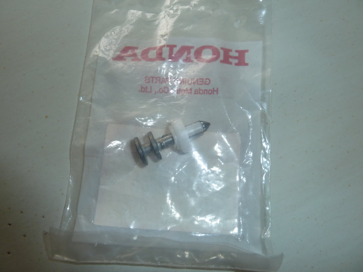

  • At Defogger connector A (at the left C pillar), disconnect the connector and with a voltmeter, voltage is checked with defogger turned on. Black lead to chassis ground and red lead to Grn wire connector A. Connector B is at the right C pillar is a ground connector. Both respective connectors are located behind the C pillar trim panels, where the airbags are. Since there are the air bags in that area, the negative battery cable must be removed from the battery for at least 3 minutes prior to any work. There are several different type of clips holding on the panel. One type is a non-reusable type, which must be replaced when the panel is removed (see attached pic.). A mallet is used to hit the area where the non-reusable clip is located to release that clip. The other clips pull out and are re-usable.
