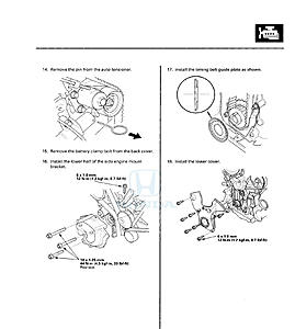

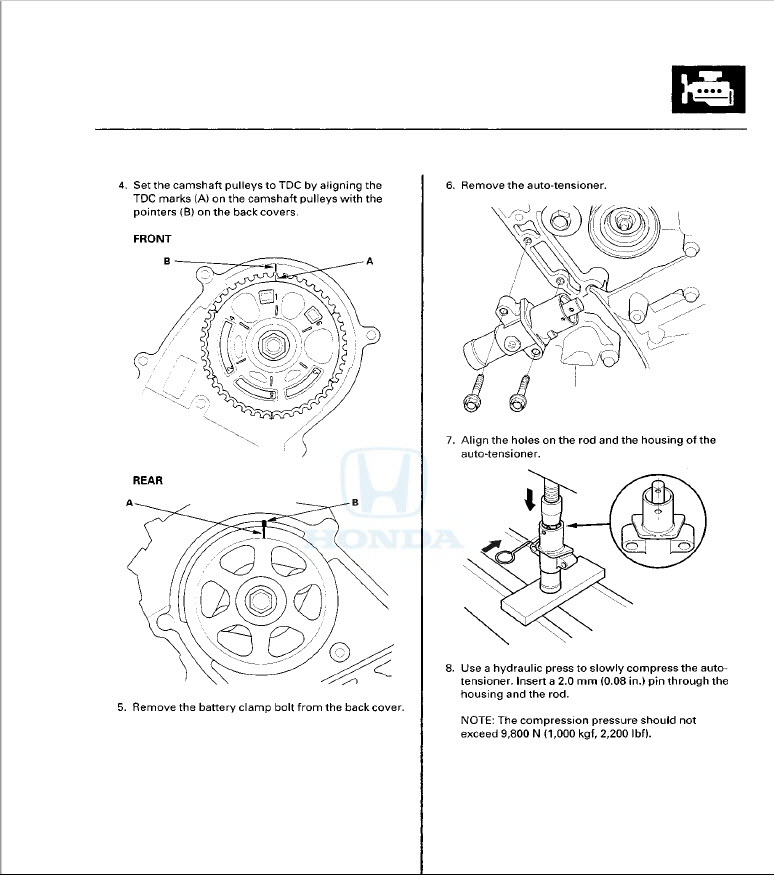

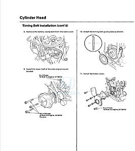

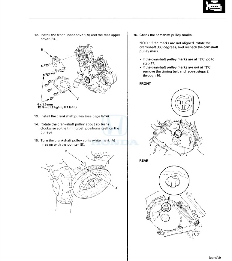

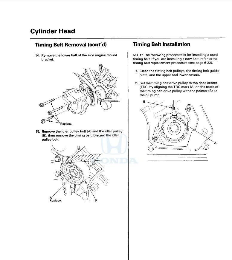

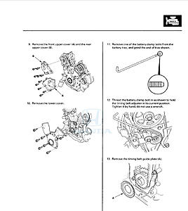

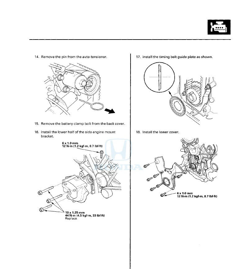

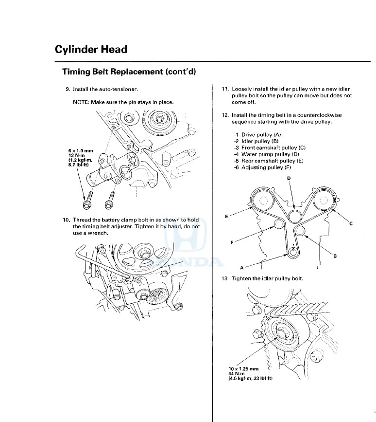

Old Feb 26, 2018 | 07:42 PM

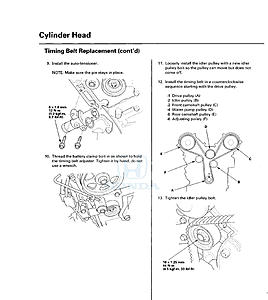

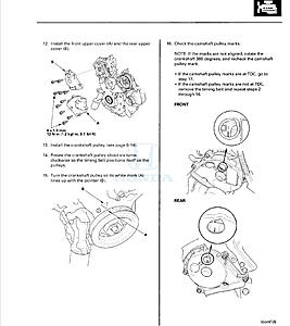

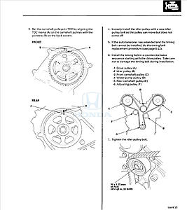

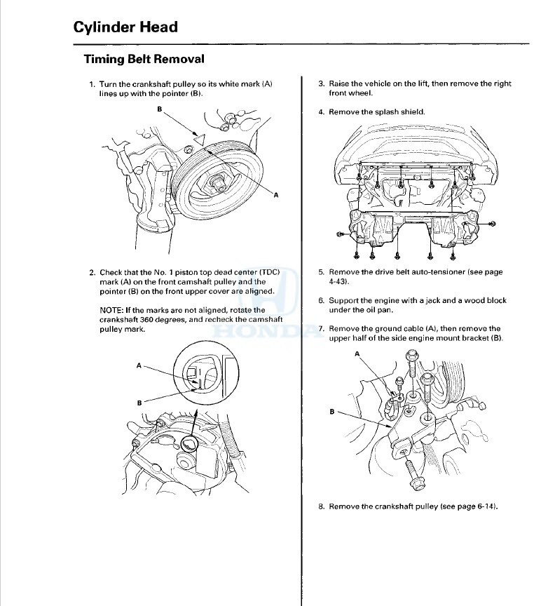

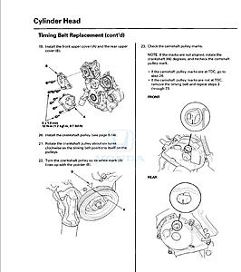

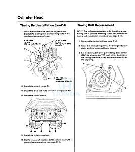

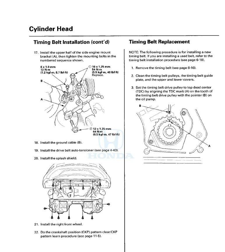

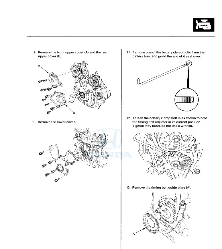

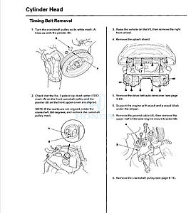

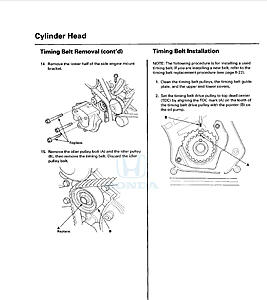

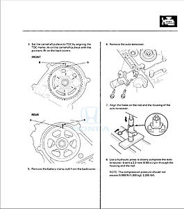

These are timing belt removal, installation and replacement instructions.
Attached Thumbnails 2009 Accord 3.0 timing belt tensioner install-timing-belt-removal-1.jpg   2009 Accord 3.0 timing belt tensioner install-timing-belt-removal-2.jpg   2009 Accord 3.0 timing belt tensioner install-timing-belt-removal-3.jpg   2009 Accord 3.0 timing belt tensioner install-timing-belt-removal-4.jpg   2009 Accord 3.0 timing belt tensioner install-timing-belt-removal-6.jpg
2009 Accord 3.0 timing belt tensioner install-timing-belt-removal-7.jpg   2009 Accord 3.0 timing belt tensioner install-timing-belt-removal-8.jpg   2009 Accord 3.0 timing belt tensioner install-timing-belt-removal-9.jpg   2009 Accord 3.0 timing belt tensioner install-timing-belt-removal-10.jpg   2009 Accord 3.0 timing belt tensioner install-timing-belt-removal-11.jpg

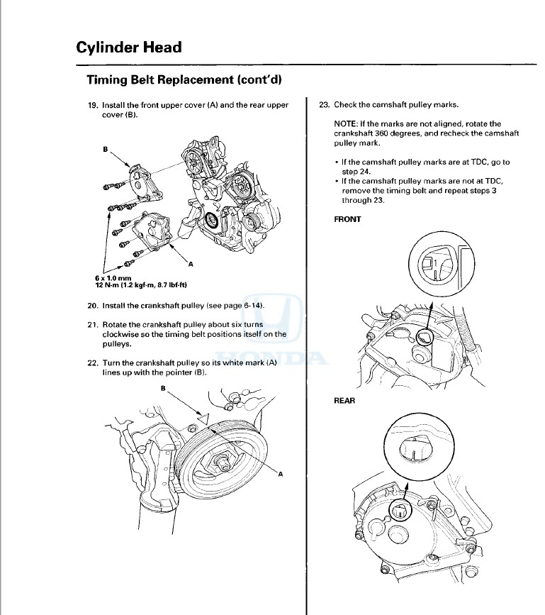

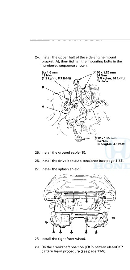

...Continued.
Attached Thumbnails 2009 Accord 3.0 timing belt tensioner install-timing-belt-removal-12.jpg   2009 Accord 3.0 timing belt tensioner install-timing-belt-removal-13.jpg
