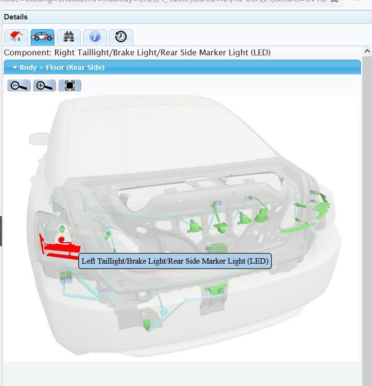

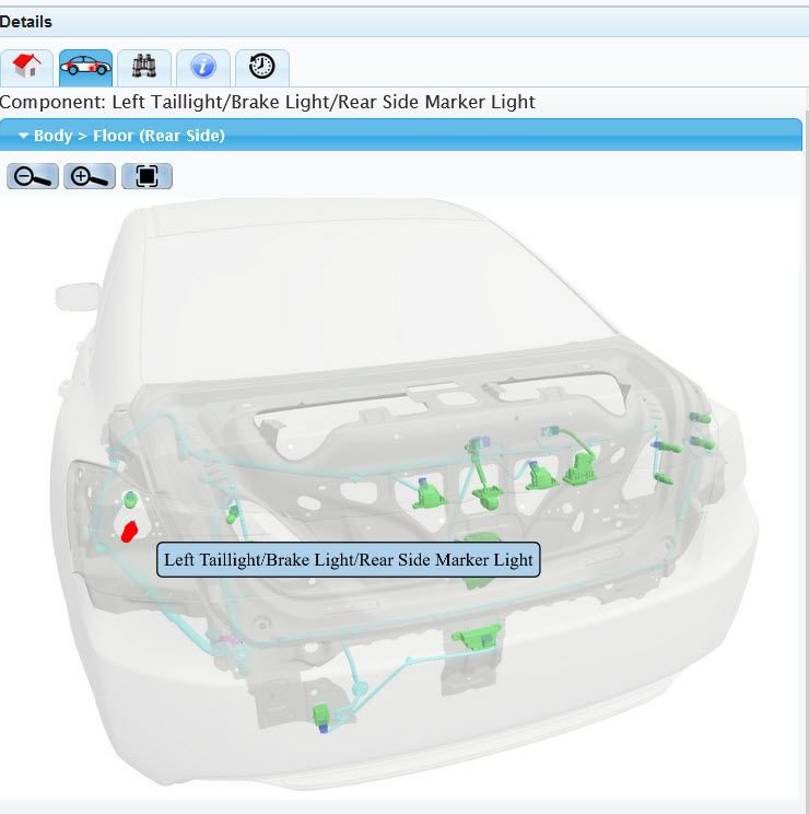

I recently purchased a V-6 2015 EX-L Accord with LED DRLs (at least in the front) and LED brake lights, and when I got it inspected the mechanic said the rear DRLs were not coming on. Can anyone say whether this model even has rear DRLs? Thanks!
The particular question is if the engine is on, with the headlights off and the brake not engaged should anything in the back be illuminated?

Different model trims have different illuminations.
  • Models with LED type brake/taillights have LED side markers and the taillights when the headlight switch is on..
  • Models with bulb type brake/taillights have the taillights when the headlight switch is on.
http://techinfo.honda.com/rjanisis/p.../A2A154DOM.PDF

Thanks! Those diagrams are really helpful. I have a V-6 EX-L.
