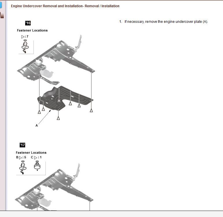

2016 model Accords used one type of clips that are removed and reattached with a flat-head screw driver.
Honda part no.90674-TY2-A01
(2017 models used two different types)
You can buy generic replacements too.
Old Jan 30, 2023 | 12:05 PM
If you are missing any of the metal clip pieces that those plastic clips attached to, then the part number is: 90673-TY2-A01
Old Jan 30, 2023 | 12:38 PM
dctaz37's Avatar
Joined: Jan 2011
Posts: 167
Thanks. I was missing some of those flat head fasteners but ordered replacements. I think the item I'm looking for is C in your diagram but picture is cut off. Do most people remove the pan all together? all the videos I looked at to change the oil do not have a pan.
Old Jan 30, 2023 | 12:39 PM
The cut off image is for 2017 models, not 2016.

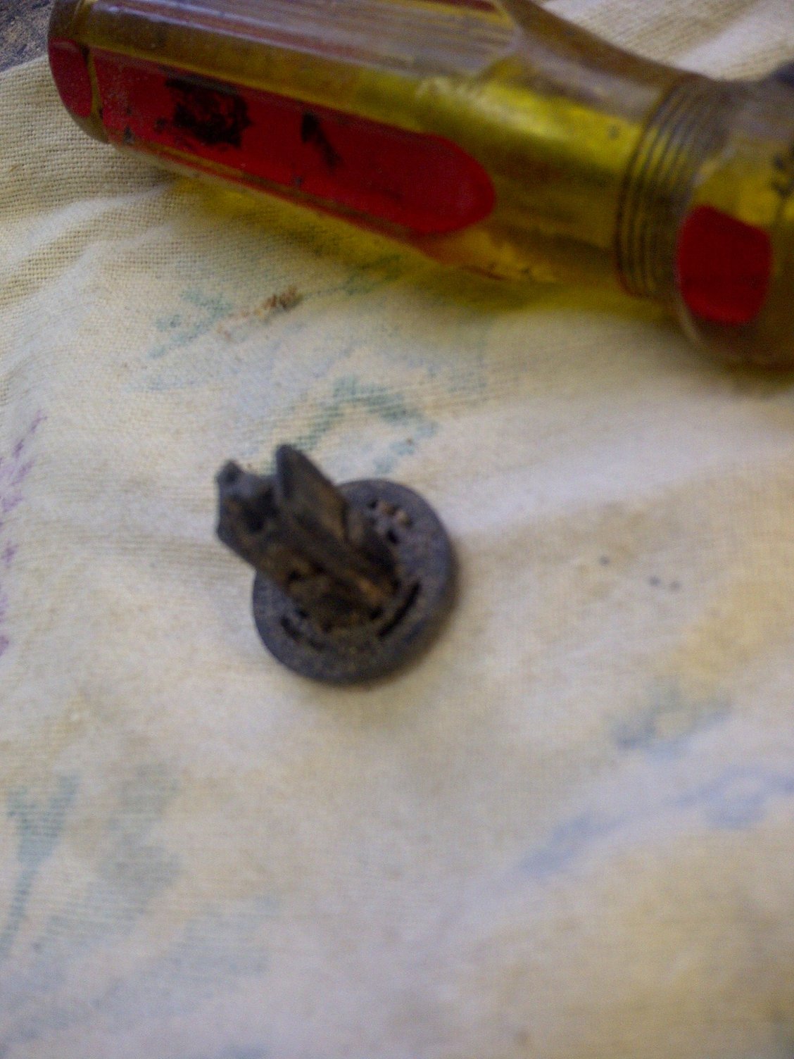

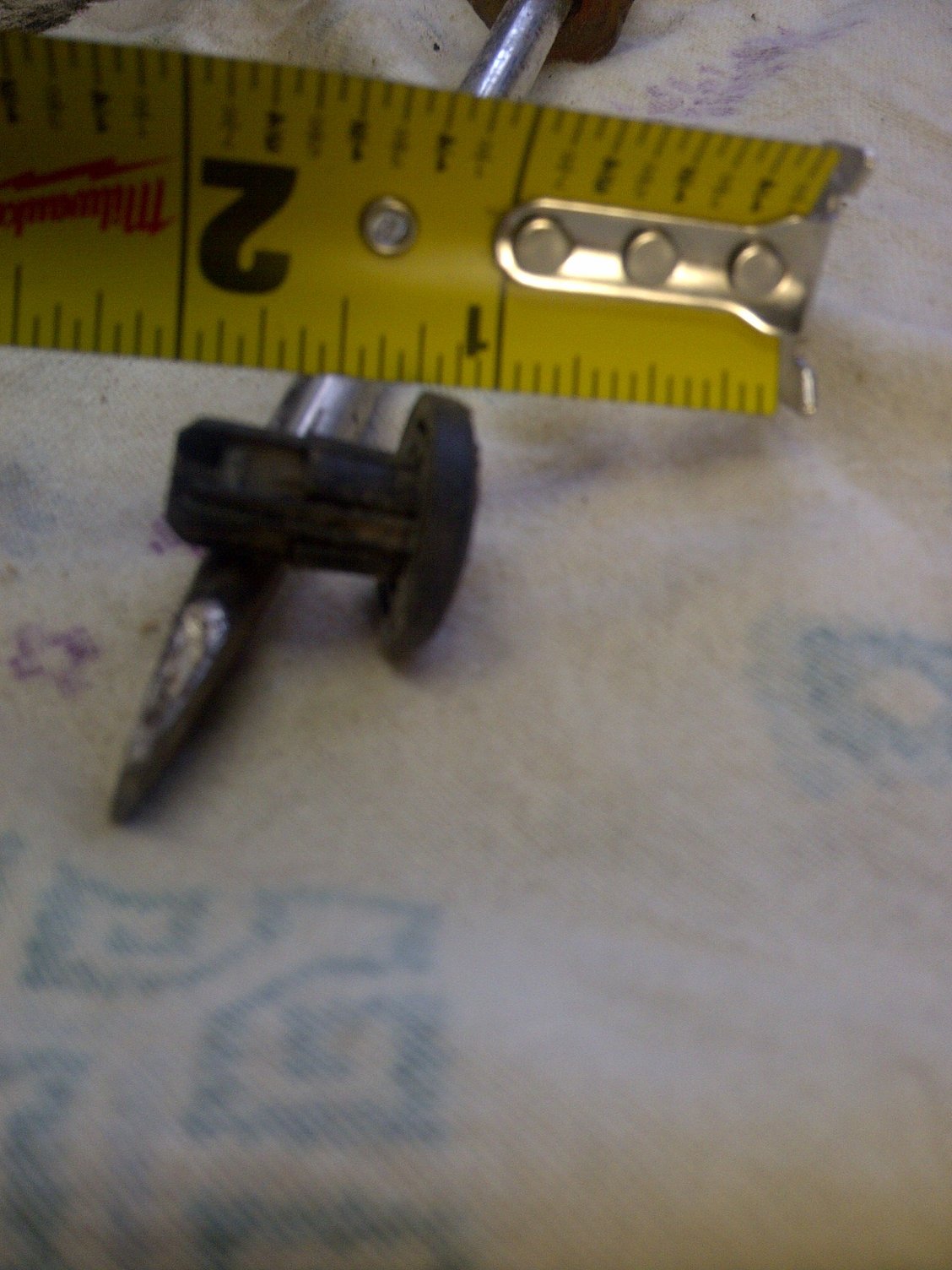

Here are some pictures of the fastener I need.
Old May 15, 2023 | 04:26 PM
That clip may be Honda part # 91501-TR0-00 or 91505-TM8-003, depending on the location and the undercover part.
