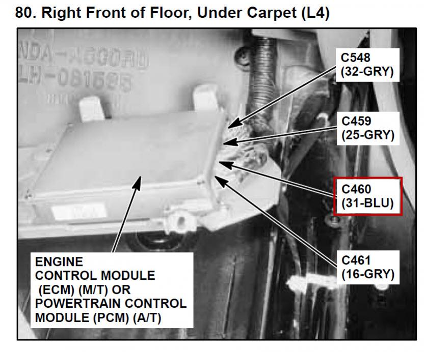

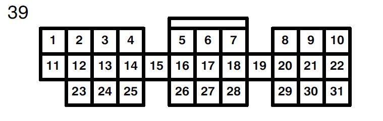

Now check the wiring going to the ECM.
On the ECM, look for the 31-P Blue connector (Connector C460). Terminal pin C4 on the ECM is CYP sensor input and C14 is CYP sensor ground. CYP sensor ground is a BLK wire going to C14, CYP sensor input is a Yellow wire going to C4.
With the distributor connected; at the ECM, disconnect the 31-P Blue connector and measure the resistance on the wire side (female terminals) of the 31-P connector between C14 (Black wire) and C4 (Yellow wire). The resistance there should be the same as the reading you got at the distributor.
Attached Thumbnails 3 stalls 96 accord P1381-ecm-pcm.jpg   3 stalls 96 accord P1381-pin-out.jpg
