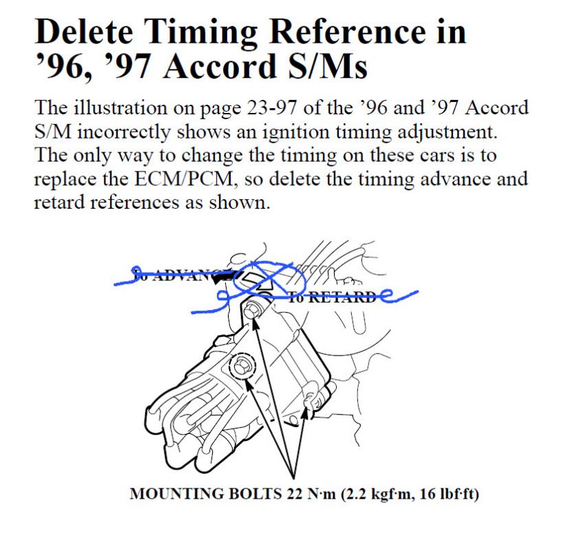

Good point if the manual is for other markets (e.g., UK/Euro). However, sometimes there have been typographic errors in service manuals too. Some errors are caught and Honda may issue a Service News article regarding it. Here is one example:
https://www.hondaaccordforum.com/for...istributor-jpg
