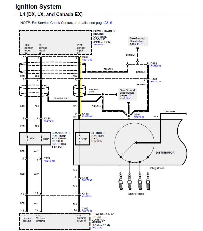

CYP sensor resistance is measured on distributor side connector at the Orn and Wht wires.
If resistance measures good at distributor connector, reconnect the distributor to harness and make resistance measurement again at the ECM connector on same wire colors; connector B.
Old Oct 7, 2013 | 01:15 PM
The CYP wires to measure resistance at the ECM are Black and Yellow. The C460 connector (31-P connector) at the ECM is considered Connector C.

ok, I'm getting 391 ohms at the pins on the distributor side.
Old Oct 7, 2013 | 02:55 PM
Then it may be an issue with the CYP sensor. The CYP sensor is part of the distributor housing.

I'm also getting 391 ohms at the ECM connector.
So I'm guessing I need to get a new distributor w/CYP sensor? or am I checking something else first?
Old Oct 7, 2013 | 06:04 PM
  #17
It sounds like the CYP sensor is bad. There are no other tests. The CYP wires going to/from the ECM sounds good.
