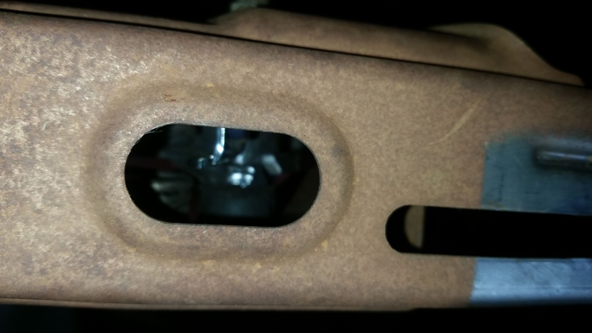

Hello, I'm new so want to say hello first of all.. Secondly I'm having a problem, recently my 01 decided it didn't wanna go into gear not long after I felt a pop in my clutch pedal. Well I removed the pedal a week ago and found that the top part of pedal welds have snapped so I'm not getting enough pedal to disengage clutch. Anyways, I can't find another mt in my local junkyard but can find plenty of 96-00 civics (which I have a 98). It APPEARS that my 98 is very similar in how it mounts. Holes seem to match up. Without removing the one from my civic can anyone tell me FOR SURE if they are interchangeable or not? Thanks guys.
--below are pictures of where it broke, anyone ever seen this happen?? Normally brackets break, never seen this

Go to a site like hondapartsnow.com and look up the oem part number for your car. Then open the same site and search by only the part number (no car information). That should list all vehicles that use the same honda part.

Well yesterday I went and got a clutch pedal out of a 98 Civic brought it home to match up with mine from my 01 Accord and the housing and pedal is a perfect match it set for one of the sensors that has the welded nut on the bottom. The one on the Civic has a smaller nut and sensor. So all I did was pull out the pedal from the Civic put it in my housing on my 01 Accord and installed it today with no problem. There for anybody that runs across this problem again can use a 96 to 2000 Honda Civic clutch pedal and use their Accord housing. If their housings bad you can use a Civic housing and drill out the hole a little bigger for the Accord sensor and weld a bigger nut to it.
