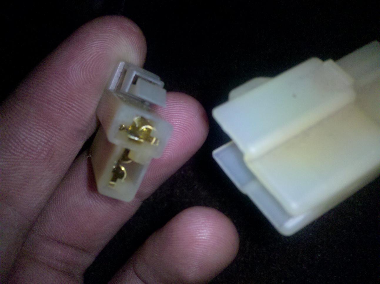

the attached picture is what i believe is the 2 prong connector that i put the paper clip into. its located right underneath the glove box, and was in the holder on the right. if this is wrong please give me more information as to where it should be located. i put a metal piece similar to a paper clip into each, and even tried the end of a coat hanger. neither did anything. i then drove the car until the check engine light came back on, put the clips back in while the car was running, check engine light stayed on and solid. turned the car off, put the clips in, turned to accessory and still nothing. any help would be much appreciated. thank you in advance

Don't plug anything into that connector. Your 88 accord has a different procedure to get the error codes than the 91-95 accords. It is pretty simple.
Procedure: Access ECU (located under Front driver’s seat) by moving seat all the way back. Turn ignition on (II position) and observe LED on ECU for codes.
Codes: Codes blinked out by LED are separated by two second pause, then repeated. For example: 2 blinks - two second pause - 2 blinks = code 2

Drivers seat all the way FORWARD, stand on your head on the rear floorboard to look under the front seat.
There is a little window covered by a plastic door; under that is a blinking LED
