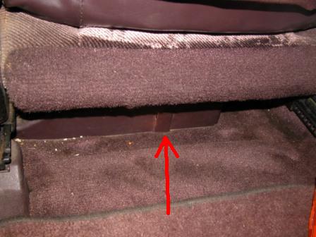

Anyway, slide the drivers seat all the way forward. From the back seat, look under the drivers seat, you will see a "plastic box". To the inside/center console of the box there will be a "flap" on that box, open it....pull from the top. There will be a red light there.
Turn the key to on/pos II (where the key would be as you are driving down the road). The red light will blink the code......you will want to watch and count it through several cycles to be sure you get the proper count....trust me, doing this alone, by the time you turn the key to "on" and get your head behind the seat you have already missed a few "blinks" of the light.

Sorry, bad memory, just went outside and looked.....pull the "flap" from the top - down
Here is a pic
Attached Thumbnails 89 accord LXI engine light on-3rd-gen-ecu-locationjpg.jpg
