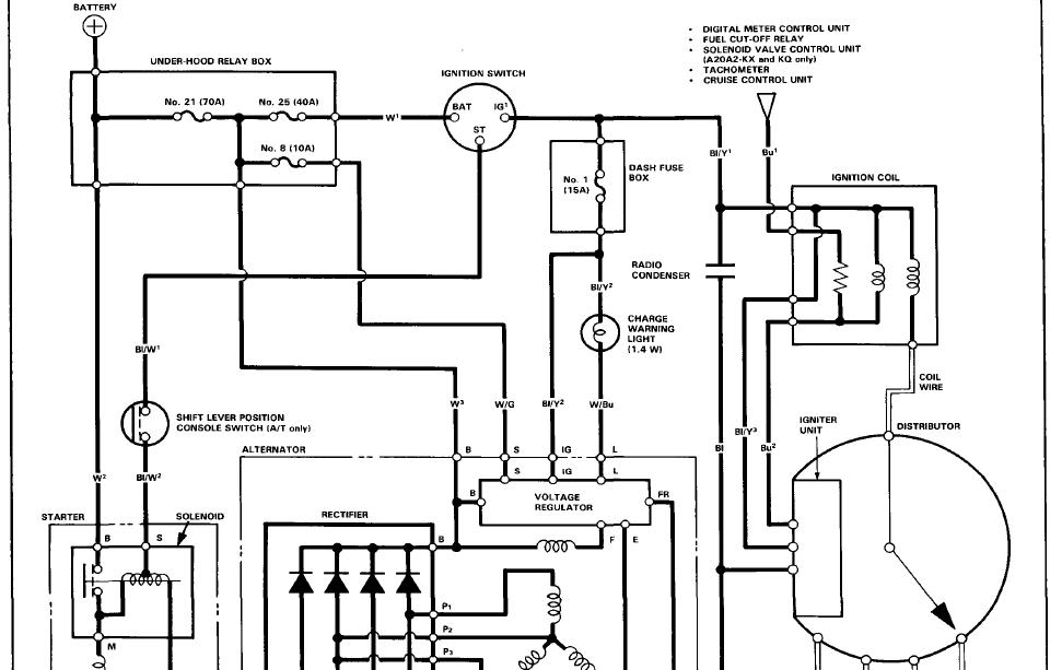

Okay, installed battery. Nothing changed. Still only the initial spark coming from the coil. Im wondering if its the ignition switch now. I looked it up and came up with fuel pump cut off switch? Are they one in the same?
Old Dec 31, 2012 | 03:31 PM
Ok, again lost in terms - I thought you meant that with a charger or jump the car would run.
Double check the ECu/Clock fuse in the under hood fuse panel. Also turn the key to on/pos II and check for codes in the ECU - it is under the drivers seat.
The BLK/YEL to the coil is "hot" with the key on. Check this when the key is on, for the first time and also as someone tries to crank the car.

Thanks for all your help Poorman. Looks like the motor mount was broken that attaches to the engine block and tore the timing belt. So, if the timing belt was there, it would run, but the engine would only be held in place by the transmission mounts. Engine is cast, so we cant weld to it. The car is done.
