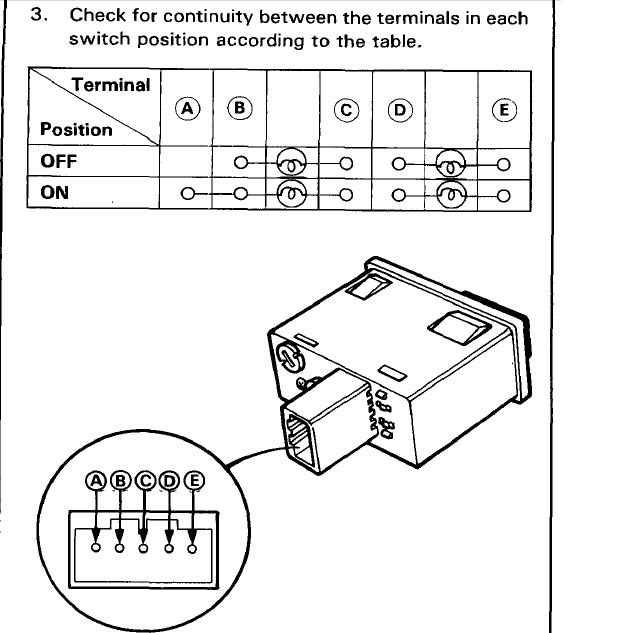

Sounding like the "switch" is bad......power in but not out. See if these test prove out. I was able to clean the switch on one of mine before. You should see the "tabs" on the switch to pull it apart.
