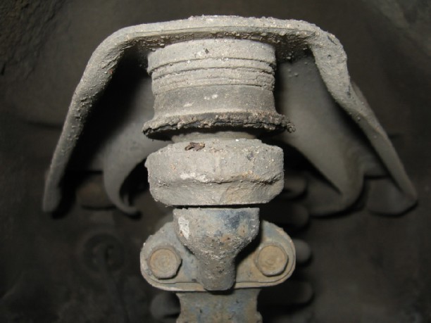

I noticed that the arms (that are connected to the upper ball joints) move with the turning of the tire...doh! I can clearly see that the upper ball joints have lots of small cracks in the rubber. Almost looks like the rubber on the upper ball joints is compressed too (But, maybe that's the shape, but common sense tells me that if the rubber has small cracks, they need replacing. I will take some pics and post on here soon).

Here is a picture I took of the upper ball joint (or what is left of it). The other upper ball joint is just as bad.
