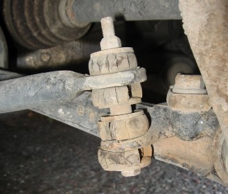

Default Could my stabilizer bar link bolts being shot cause steering wheel/car wobble?
I notice that the bushings on the stabilizer bar link bolts (or end links?) are totally shot. I am wondering if that's one of the reason my steering wheel sometimes wobbles from side to side and why I notice my car wobbling when at slow speeds? I have attached a pic of one of my link bolts.
Can I replace the link bolt and bushings without removing the stabilizer bar?

Yea, those need to be replaced-understatement. I can't say they are the issue but they are bad.
The bar stays in the car, you will need to remove/replace the end links.
