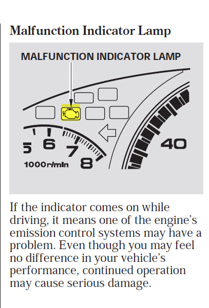

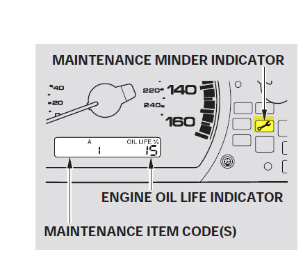

There are indicator lights on the gauge cluster meaning different things. From the attached pictures, are you referring to the Malfunction Indicator Light (aka Check Engine Light) or the Maintenance Minder Indicator?

It is the malfunction indicator lamp. I'm assuming I should still take it to the auto parts store?

Thanks redbull-1, as I was reading the first post I was thinking the same thing about the "lights", I was going to ask the same question - is it the little "wrench" or the little "engine"
