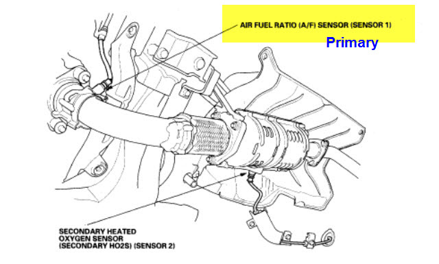

redbull-1,
I think you are talking about the secondary sensor? I need to replace the primary sensor?
Old Aug 7, 2012 | 09:05 AM
  #22
Posts: 7,101
That is the primary sensor for the four cylinder. The four cylinder has the air/fuel ratio (primary) sensor before the cat and the secondary O2 sensor at the cat.
Attached Thumbnails 90K 06 Honda Accord LX SE - Check Engine Light Went On-2003-2007-accord-l4-af-sensor-o2-sensor.jpg
