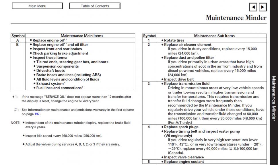

Old Apr 4, 2012 | 02:06 PM
The 2006 Accord was when Honda added the maintenance minder; so, technically, there isn't a 90K maintenance like earlier Hondas. If your car is an automatic, I recommend changing the ATF fluid at least every 30,000 miles regardless of any maintenance minder. Honda's automatics sometimes are problematic.
Attached Thumbnails 2006 Honda Accord 90k Maintenance-maintenance-minder.jpg
Old Apr 4, 2012 | 02:20 PM
Dr. Drivability's Avatar
Joined: Aug 2011
Posts: 1,149
good point on the tranny fluid for automatics, cheap insurance...
