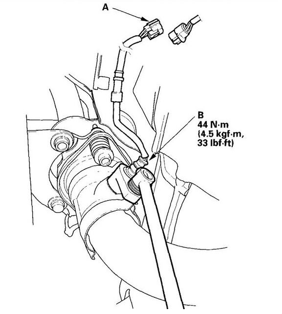

My light came back on and has been on more consistently. I figured out that it is the primary O2 sensor that I have to change (the one near the manifold). Can anyone point me to some instructions on how to do this?
Thanks,
sc30317
Old Jul 11, 2012 | 10:12 AM
  #18
Posts: 7,101
Essentially:
  1. Jack up car and support with jack stands.
  2. Disconnect electrical connector for air/fuel ratio sensor.
  3. If necessary, spray some penetrating oil and let it soak in for awhile.
  4. Use an O2 sensor socket or wrench and remove A/F sensor.
  5. Install new sensor.
Attached Thumbnails 90K 06 Honda Accord LX SE - Check Engine Light Went On-2003-2007-accord-l4-af-sensor-o2-sensor.jpg

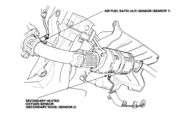

Redbull-1,
Do you have any other pictures of this? Still trying to figure out exactly where this is. Also, what tools will I need? I was reading that I might need a socket set to remove O2 sensor that I could rent from Autozone. Is that true?
Old Aug 6, 2012 | 09:37 PM
  #20
Posts: 7,101
Look under the car, it is the one forward on the exhaust pipe (they call that pipe area the exhaust manifold).
An O2 sensor socket (which has a slit in it for the wire) will make the job easier; but, on some cars, a regular wrench can be used.
I have this other picture; but, the first one I posted is more representative of the location.
Attached Thumbnails 90K 06 Honda Accord LX SE - Check Engine Light Went On-2003-2007-accord-l4-af-sensor.jpg
