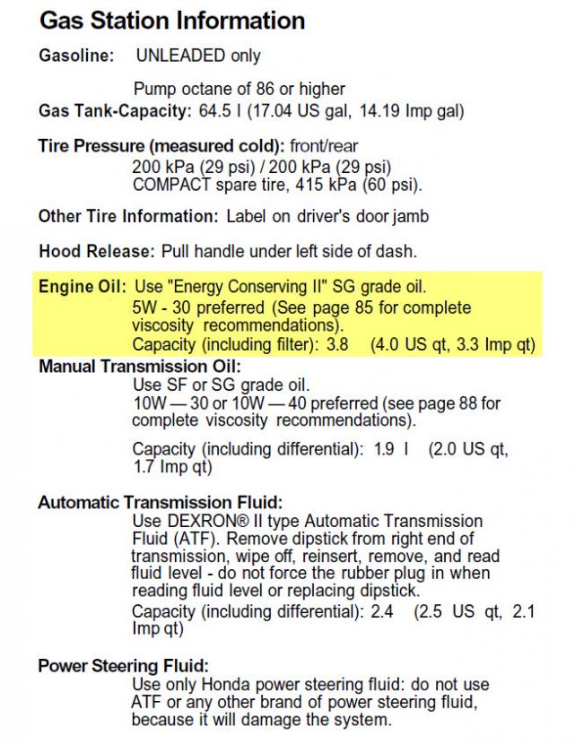

5W-30 is the recommend oil viscosity for your car.
Attached Thumbnails 91 Honda accord lx. Oil change now won't start-gas-station-info.jpg

X2 on the oil. Your car takes 5w-30. Changing oil viscosity will affect engine lubrication, so use only what is recommended in your honda owner's manual.
