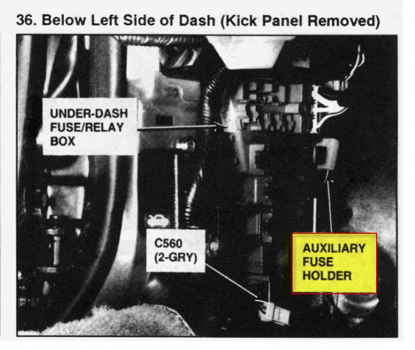

Kind of hard to read everything you wrote. I'll respond to some issues in separate posts.
Issue: No turn signal or hazard lights.
First check the fuses.
  • Under the driver's side dash, your car has an auxiliary fuse holder. Check the 7.5A fuse in the auxiliary fuse holder to see if it is blown. You may have spare fuses in the under dash fuse box (see image for locations), only use the same amperage fuse. Do not use a higher amperage fuse.
  • Under the hood, there is another fuse box, check if the No. 20 (10A) fuse is blown.

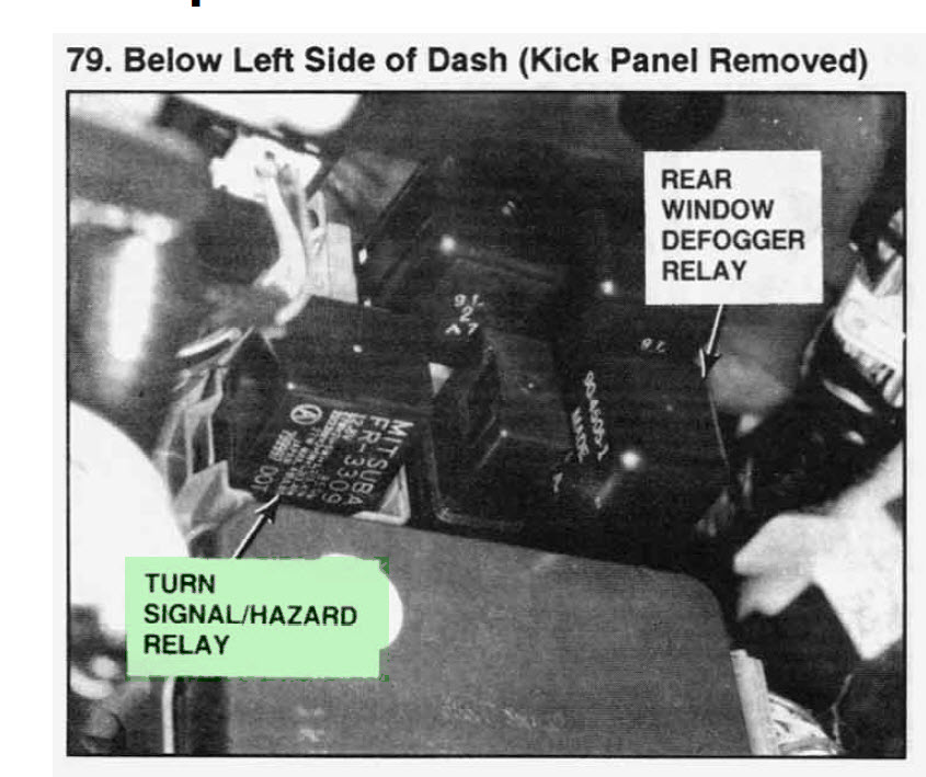

If fuses are okay, can be a problem with the hazard switch or the turn signal/hazard relay. Maybe even wiring or a connection problem.
The turn signal/hazard relay is located in the under dash fuse/relay box. The relay can be tested if you have testing equipment.
