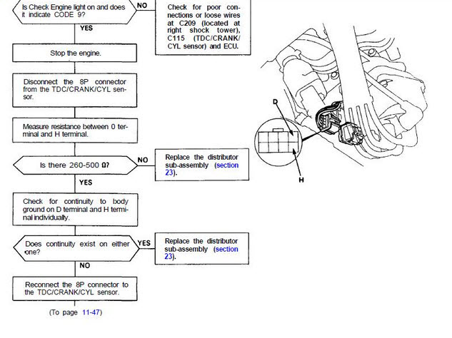

redbull-1 the check engine light is on it reads code 9
Old Jul 21, 2013 | 11:23 AM
  #18
Code 9 is for the CYP sensor in the dist.
Have a volt meter to do some testing?
Old Jul 21, 2013 | 11:31 AM
  #19
Attached are the troubleshooting procedures for Code 9.
Attached Thumbnails 92 honda accord wont start-code-9-troubleshooting.jpg   92 honda accord wont start-code-9-troubleshooting-continued.jpg
